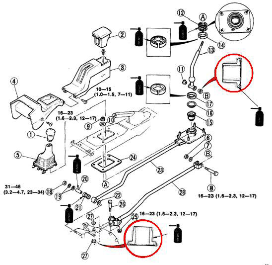

          The factory bushings aren't worth anything, buy the $34 Corksport bushings... you won't regret it.

            Awesome... where did you buy the bushing kit from?
            looking at your picture it looks like all you really need is #11, B and 15....?
              #7
              11 and 27... two on each end of the shift linkage.

                #8
                It's hard to tell from the pic, what does 27 do?
                  #9
                  bushing between the linkage bar and the tranny gear selector I believe.

                    #10
                    The #27 bushings connect the shift linkage to the tranny, the #11 bushings connect the shift linkage to the shifter. It's obvious once you get under the car, i'll take pics if you think it'd help.

                            #14
                            Ya... there's quite a bit going on in that pic, I think I get it... does rod #28 connect to rod #23?
                            Up till this car I've always owned rear wheel drive cars and the stick bolts directly into the tranny so I'm a newbie to this type of set-up....
                              #15
                              the rods work in unison. One rod holds the shifter in place. The other selects the gear off of the shifter pivoting.
