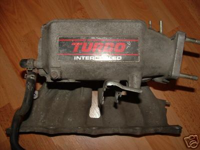

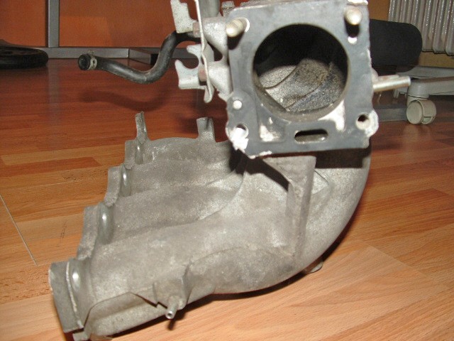

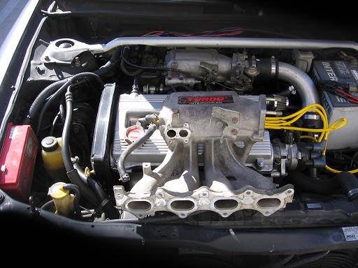

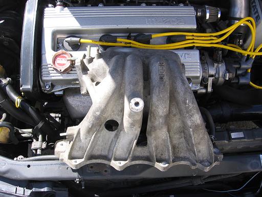

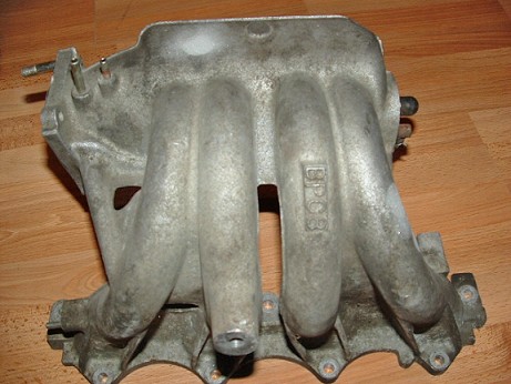

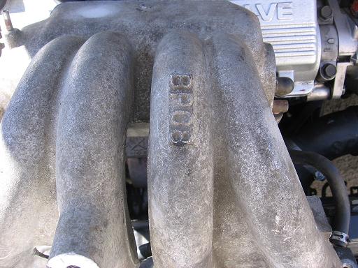

Intake Manifold
With the "Big Turbo", it has become critical that boosted air is distributed to the individual cylinders in equal volume and pressure. Likewise, the energy of exhaust gas must be fully exploited to quickly "spin-up" the big turbine in order to obtain high power and minimum turbo lag.
The Mazda engine design team has perfected a unique manifold system, combining the air volume and pressure equalizing intake and exhaust extractor manifolds.
It was Mazda's finding that with more a more commonly used equal-length intake manifold, the tract nearest to the air entry received the least volume/pressure, and the farthest tract the most. By trial, measurement and testing, the engine team perfected a cast aluminum manifold that has intricately curved and sized "walls" between the individual tracts leading to the intake ports to equalize air volume and pressure. A bonus is that the manifold's swirl generating effect contribute to efficient combustion. The equalizer intake manifolds have shown its effectiveness in improving torque from idling to the Group-A 300-bhp-plus output level and all the way up to maximum revs.
